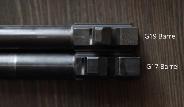

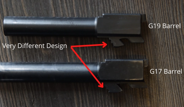

Here are a couple good photos showing the difference between 17 and 19 barrels in gen 2-4 glocks:

I would try pulling the slide back enough that the recoil guide rod is sticking out the front of the slide, then hold the guide rod with pliers and then carefully let the slide forward while pulling down on the slide release levers to let the slide off the frame.

I noticed you showed the differences of barrel dimensions between the gens and then posted about using pliers. So, the pliers is to help guide the guide rod back into alignment?
I screwed up. I put my 17 slide on my 19 frame to see how it would look and it got stuck. I removed the back plate and the plunger rocketed out. The extractor and the firing pin safety then fell out. I removed the firing pin assembly and it's stuck. I can cycle the slide but nothing is budging. What can I do to disengage it and take the slide back off?
No.
Pulling the guide rod away from the barrel lug is to get the guide rod out of the way so you can get the slide release latch to clear the rear of the guide rod and let the slide move forward past the latch.
