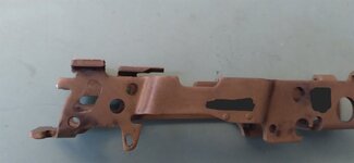

Before pic, note I outlined the area to cut with a black pen and the FCU has a "starter" hole from the factory (why don't all FCUs just come with the complete cutout?):

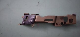

After pic:
