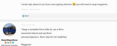

I wrote clips above to see if you were paying attention
you will need to swap magazines.
