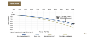

50” less drop at 1,000 yards when compared to 7prc? Am I seeing that correctly?
I’m not a long range shooter. Is that a significant difference?
If it indeed works out that way, yes at 1K 50” is worth pursuing. It would account for greater margin of error in making wind calls, drop calculation, shot correction, etc. The bullets to realize the benefits though will be on the expensive side. Reloading data will be interesting as to propellant selection.
I'd take that drop chart with a big grain of salt. I would guess Federal is comparing their best performing ballistic load to Hornady's worst performing load. If the chart had said they were using the same bullet I'd chalk it up to extra pressure creating extra velocity in the short barrel.
That said, 3000 fps out of a 20 inch barrel with a 170 grain bullet is pretty nifty.
Propellant-wise I'd guess they're using something a little faster than normal, I mean we all know how to build too much pressure, but when you're optimizing for 80k psi in a 20 inch barrel that seems like the way to go. Probably a case full of Red Dot ;)
Just for fun I ran the numbers in JBM Ballistics comparing a 7mm 166 grain Hornady A-Tip Match at muzzle velocities of 3000 fps (close to the 170 Terminal Ascent numbers) and 2850 (closer to the velocity you'd see with this in 7mm PRC out of a 20 inch barrel in my estimation) and the difference is 30 inches of drop.
If you compare a Hornady A-Tip at 3000 to a Hornady 154 SST at 3000 (again realistic for 7mm PRC out of a 20 inch barrel) the difference in drop is about 30 inches.
So yeah, at the end of the day 7mm Backcountry just has 150-200 fps on 7mm PRC, which was never designed to be a speed demon anyway. 7mm Backcountry basically does what 28 Nosler does, just with a standard bolt face and a long action with less powder. I don't know about the case design yet or if it's well suited for long heavy for caliber bullets. Federal is loading a 195 Berger, so I'd guess it's well designed for that (unlike the 28 Nosler).
Drop is not a problem because you can simply dial more elevation into the scope and hold on-target.
I can't imagine anyone is going to try and HOLD 250 inches of elevation anyways so what difference does it make if you have to put another 1.5mils of elevation on the elevation turret?
The real problem is the wind.
The bullet can easily drift 6ft off target at 1000yds and the difference between all of the cartridges being compared is going to be maybe 15% which means with ANY of the cartridges, you are going to be having to make a dramatic wind correction to hit a vital zone.
The real telling part of that promotional drop chart above is that the drop is so close out to 500yds that they did not even start their chart until 500yds.
So inside of 500yds, all the cartridges being compared are about the same.
