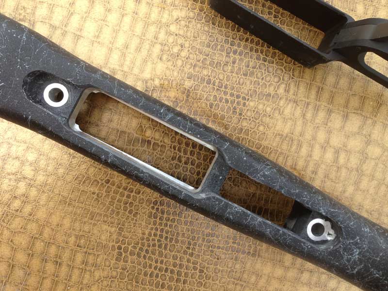

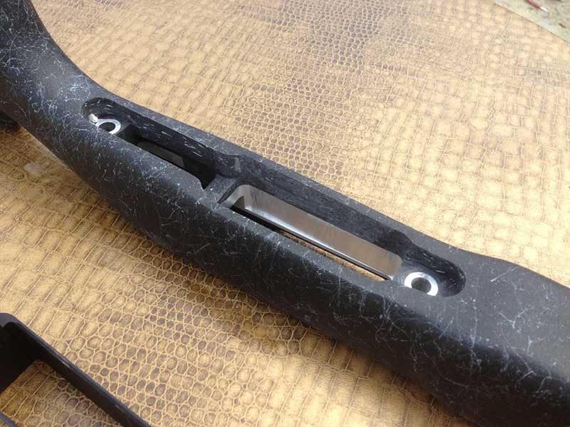

You don't need to remove much material from the stock. I didn't need to remove any material from the aluminum bedding block. The only spots on the stock that needed fitting were the front, back and sides around the magwell. I used the dremel to open up the corners around the front and back of the magwell. And the flat files to remove material from the sides of the magwell.

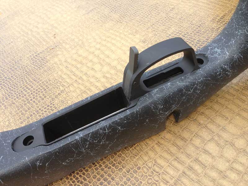

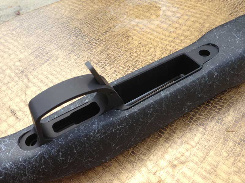

You need to remove material from the top front and from the sides, where there are some tabs that stick out. Also, behind the rear magwell "spine" a little. You don't need to remove any material from the rear magwell "spine" that sticks up from the magwell. I removed a little before I realized you didn't need to. Be careful about removing too much material on the front part of the magwell. If you remove too much the magwell will go too far into the stock and the magazine won't lock into place because it will be pushed out by the bolt.
Overall, while I could have made it look cleaner with smaller dremel files and also not scratched up the Magpul kit removing the side tabs, it functions perfectly and feels very solid.
