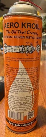

Last night I was working on my long deceased Grandfather's 1916 USMC issue / purchased Colt 1911. It has been stored away and unused for many years and back then they didn't issue USMC specific weapons so, it has the Classic US Army markings. I discovered the four screws holding the original grips in place were frozen and wouldn't budge along with the sear pin. I Didn't want to damage the flat head screws or anything else so I used a product I've been using for decades and I think it's the very best penetrating oil on the market. One drop from a toothpick on all five fasteners and this morning they came out as if they were just inserted yesterday.
This product has been around for a long time but I don't think it has the brand awareness of things like Liquid Wrench, Silicone Spray or WD-40 (yuck).
Here is the link to the company: https://www.kroil.com/products/
And a picture of a spray can. I hope this helps someone else, this stuff is remarkable. (I have zero affiliation with or investment in this firm or it's parent)

You said it right! I use that for what you described, works like a charm. I like Slip 2000 products but parts from old guns stuck Aero Kroil works like a charm!
