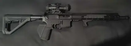

I have a featureless AR9, all it is: Ruger Complete AR lower, Palmetto State Armory 16" complete upper https://palmettostatearmory.com/psa...-13-5-hex-m-lok-railed-upper-with-bcg-ch.html , swapped the flash hider for a thread protector, swapped the grip for a Fin, and a strike industry stock stop for the adjustable stock. Currently running 10 Rnd Exomags, did debate getting the stern and running Glock mags but i don't own any other Glock mag firearms. There are cheaper ways to build one but i wanted simplicity, and the LRBHO works on the PSA upper. Running exomags you will have an easier time swapping uppers if you were to share the lower for multiple configurations.
