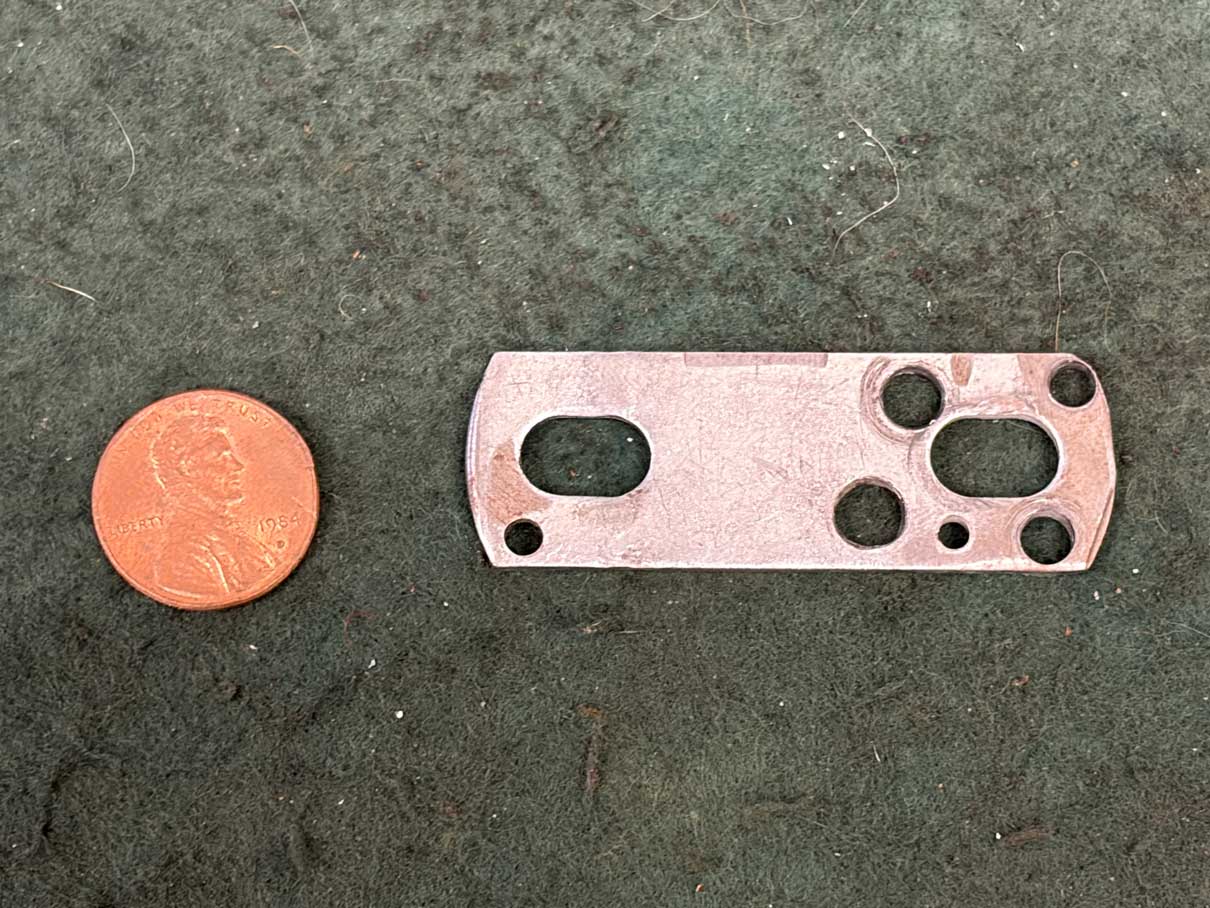

Take a little ~2.0" x 1/2" scrap piece of about 1/16" to 1/8" thick flat metal and drill a hole that the screw just slips through near a corner of the metal.
Now slip the screw through the hole and spin the screw with the appropriate driving tool while you put the end of the screw against a bench grinder.
I have drilled several different sized holes in the one I keep near my bench grinder:

If you don't have a bench grinder, you can clamp that screw holder down to a something to pinch the screw head and then file the end of the screw that's sticking up.
Make sure to deburr the sharp edges after filing so the threads will work freely.
If you leave burrs on the screw's threads, you can damage the threads you are screwing into and cause a bigger problem.
A really really fancy screw holding fixture can be found here:
I have never found the need to do all the work to make one of those.
My little scrap piece of sheetmetal from a U-Bolt has served me well for 20+ years.
