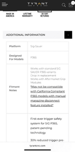

So I was looking at Tyrant CNCs trigger and they mention it not working with the mag disconnect so looks like you’re right. Now I’m curious if anyone was able to change out the trigger on a CA version.
