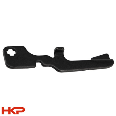

I have big hands and have had a couple issues with the slide not locking back, the slide release is rather large and my thumb gets in the way with my high grip. I ordered the low profile slide release below and will try this out. Also considering the Grayguns adjustable hybrid trigger and they also offer a service to modify the factory slide release so I might consider that if the low profile HK slide release doesn't work out.

The slide not locking back is a common issue with a standard thumbs-forward grip. The way around it is simple: Move the strong hand thumb slightly out to rest on top of the other thumb, and clear of the slide release. A quarter inch is all it takes. Or a Jedlinski "wave grip" also works, with thumbs up but look it up, he explains it better than I can. In any case it happened to me once, and I've not had a failure to lock back since making a minor adjustment.
