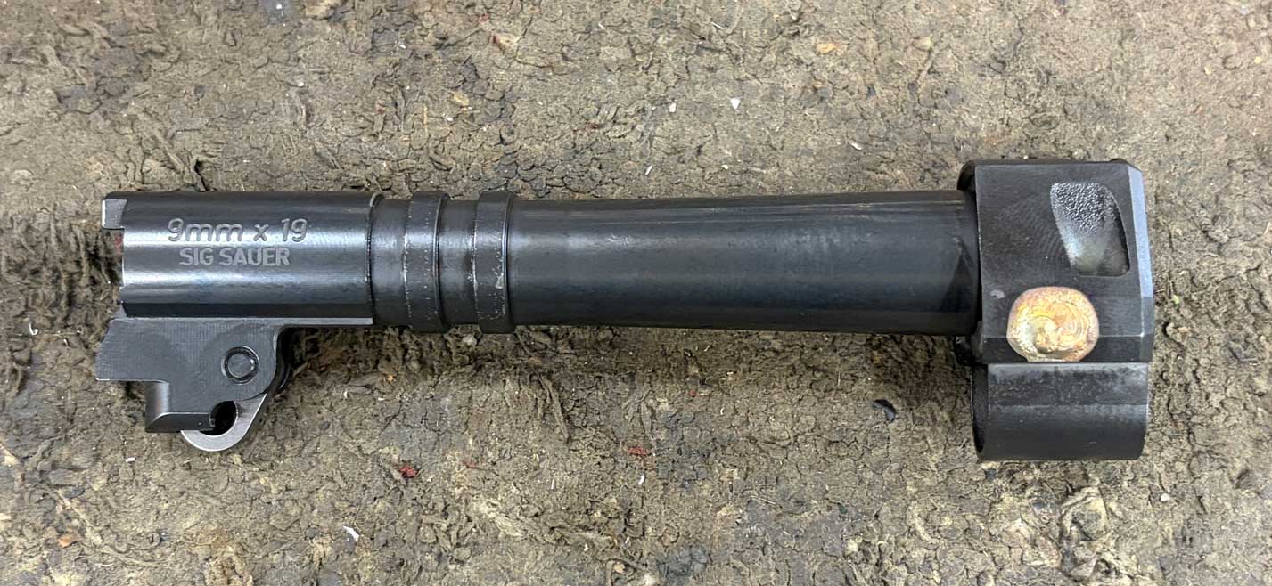

I have had a few requests about having me perm attach a GTO comp to the barrel.
I finally had one in my hands last week and I worked out the process.
I use the original Sig locking pin but I make a new locking screw that replaces the original Sig spring and setscrew.
I do this so that there's no way for the taper lock pin to be driven loose against the spring.
After degreasing everything and installing the new parts, I fully weld the locking screw into the comp.
There's no way that comp is coming off without grinding through the welded area to cut away the locking screw and then driving out the taper lock pin to allow the comp to rotate.
Here is the perm attach I did the other day:
The weld looks bigger than it is because the finish comes off of the heat effected zone around the weld.
The weld would not be as noticeable after the comp is refinished.
