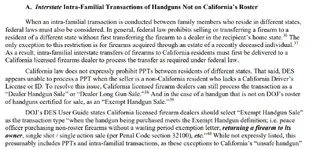

Yes, but you'll need to go through an FFL that is willing to do the inter-familial transfer (shouldn't be too hard)

Looking through both of those documents, I don't actually see any specific mention of frames though. Part of why I ask is my FFL said that there isn't even an option in the DROS system for frames in CA. But that doesn't really make sense because I know PPT of frames is allowed and presumably they just DROS as handguns even if they aren't built into a complete pistol?

Form BOF-4544A is only used for in-state intrafamilial transfers. Inter-state intrafamilial transfers have to be done through an FFL.
The FFL is either ignorant or doesn't want to DROS a pistol as frame only
I think you're right. That CRPA doc says:
California law does not expressly prohibit PPTs between residents of different states. That said, DES appears unable to process a PPT when the seller is a non-California resident who lacks a California Driver’s License or ID. To resolve this issue, California licensed firearm dealers can still process the transaction as a “Dealer Handgun Sale” or “Dealer Long Gun Sale.” And in the case of a handgun that is not on DOJ’s rosterof handguns certified for sale, as an “Exempt Handgun Sale.”
And then in the DROS Entry System (DES) Firearms and Ammunition Dealer User Guide section for Exempt Handgun Sale it says:
EXEMPT HANDGUN SALE
d. Frame Only – Select Yes or No whether the purchase is for a frame only; if Yesis selected then the firearm caliber, additional caliber, barrel length, or unit ofmeasure will not be available for updating.
Only question is if things have changed since 2020 when both of these docs were written.

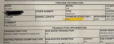

I was a buyer of a frame only, couple of years ago
