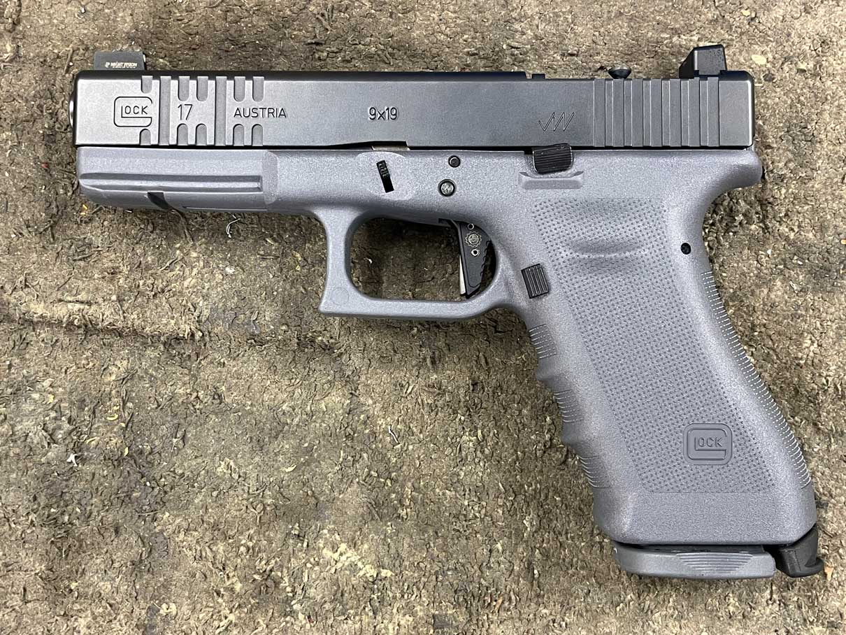

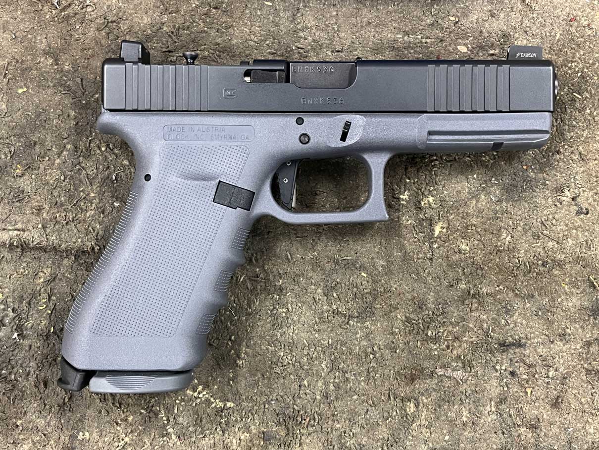

I’ve sent a couple slides to Maple Leaf Firearms. They do slide cuts, optic cuts and nitride refinishing. I’m happy with the way my G17 turned out.

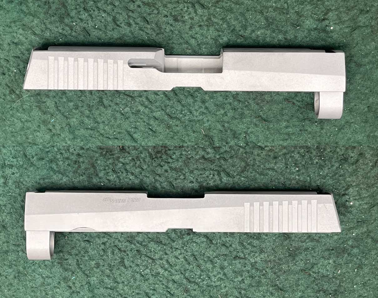

Here is a P320 slide that I cut serrations on this week.
I sent mine to Maple Leaf Firearms. I am very happy with the work. They have outstanding customer service.
