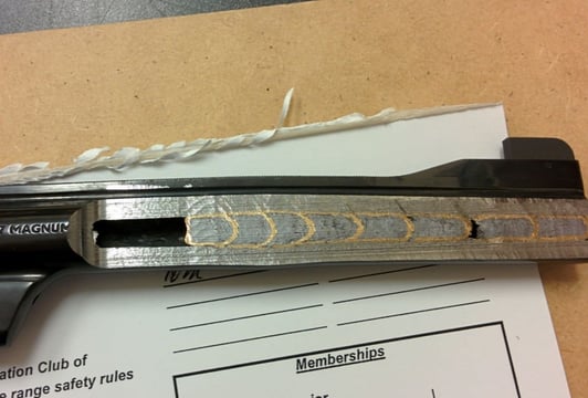

If you had a single squib and didn't stack multiple bullets in the barrel, you are GTG.
The problem happens when you have one get stuck due to a lack of powder( the squib ) and that bullet creates an obstruction. Firing a full power round into the obstruction causes the barrel to deform or bulge.
Thanks for the feedback
You can see the barrel bulge as more bullets are stacked.
Found this picture.
