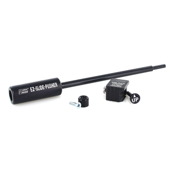

You mean the slide stop?The Dawson kit is helpful especially the plunger pin tool to remove the slide lock pin. It took me a few frustrating times to learn how to take it apart or put it back together. Be patient and go slow. Eventually it becomes secondary.
Probably. Dawson slide stop removal tool is freaking awesomeYou mean the slide stop?
Yah. That tool is handy. The rest of the kit I don’t miss much, but that might be from years of working on 1911s/2011s.Probably. Dawson slide stop removal tool is freaking awesome
HD was my first 2011/1911 and I too don’t use the rest of the kit.Yah. That tool is handy. The rest of the kit I don’t miss much, but that might be from years of working on 1911s/2011s.
are the first few times really hard because it's brand new? I tried pushing it out with my finger and it wasn't budging. Had to use a small tool, the gun is brand newDon’t really see point of kit, removing the slide release is simple tooless. Just push it out with finger through the ejection port.
Not sure if new or technique not perfected as same thing happened to me and it became really easy after a few tries.are the first few times really hard because it's brand new? I tried pushing it out with my finger and it wasn't budging. Had to use a small tool, the gun is brand new
