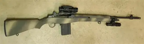

For anyone who mounted a scope on your Springfield M1A at the receiver, not scout mount, how did you do it? What mount did you use? Were you happy with it?
Bula xm21 has machined pic sections, sadlak scope mounts, arms #18 mount, extended top rail scout mounts. Quite a few options but ive heard the best reports from the sadlak mounts
I did and I used a Sadlak. It’s very solid and their customer service is very good. The mount is solid if you follow instructions well. On a funny note it’s a garbage in garbage out kinda thing. Never had an issue once. Also buy the national match spring guide. They are always sold out so keep checking. It is much smoother charging.
That being said I personally like shooting my M1a with iron sights better. Right now my scope and mount are sleeping in my safe 😊
I have an M1A loaded and used the one that has a single bolt on the left and goes into the dovetail left open from removing the clip guide. It was a piece of 💩 but worst of all way too high. I took it off and shot irons for a good day and liked that better. It hits 400 yards all day long if you know what you are doing. It's the best iron sight rifle I own.
A receiver with machine pic sections would be ideal, but they all seem very expensive. From what I’ve seen online, the Sadlak and arms #18 seem the most popular. Sadlak has a lot of versions.
Sadlak seems pretty well-regarded online. I wish I could use the irons, but my eyesight doesn’t do well with irons. It’s too bad because the rifle is really made for irons, not optics.
Do you know who makes that mount? Sounds like one to avoid.
I just have the crappy steel Springfield Armory mount that sits high enough that I can still use the irons on my M1A Scout. I only use a Burris TAC30 variable 1-4x illuminated optic without any cheek riser. I think the cheek risers look bulky and stupid. It works for what I want it to do. If I need more magnification, I'm using my AR or bolt gun. My M1A National Match just has iron sights as intended. But I've wanted to get a Sadlak mount to replace the factory Springfield mount.
