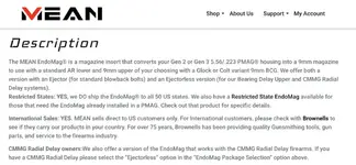

Apologies if I’m ambushing here but I’m basically trying to get a MEAN Arms delayed upper without the wait if there’s any insight.
Setup as close to a standard AR as possible.
Looks something like:
- standard AR-15 lower
- Mean Arms mags (AR-15 dimensions)
- roller delayed and/or can accept standard AR-trigger
- LRBHO
