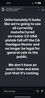

Thanks for the info. I just heard all CZ pistols are being taken off the roster. Not sure what’s going on
My local gun store posted this. If anyone has any more info please feel free to share. I’m worried I won’t even be able to get any CZ at all after this.
