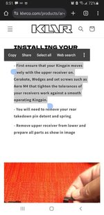

Kingpin / Maglock and Locking Back Bolt
Um yea. Best of gunsmiths are always a student. Just because one has a gunsmith business can't shoot down other people's solution, especially when a manufacturer says something similar.
Mic drop.
Mic drop.
You clearly don't understand what I posted or what you posted as your mic drop.
Read the very FIRST sentence in your screengrab.
That is about the kingpin sliding in the lower.
The setscrews prohibit the kingpin from sliding freely because they tension the upper against the lower.
Setscrews are not in contact with the upper when the upper separates from the lower so they have no effect on the freedom of the kingpin sliding.
Nor do setscrews have any limitation on the OPENING distance between the upper and the lower.
The setscrew only limits the CLOSING distance.
This "tensioner" can make the king pin not separate the upper and lower at desired gap to get the king pin and maglock to not work properly.
Source: me.
Quoting to explain exactly what the above post is concerning.
