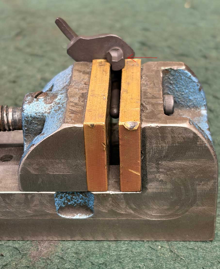

1911 safeties come oversize on purpose so you can fit them.
Start by making sure the safety can fit into the fully stripped frame.
The shorter safety post must move up and down freely within the oval cut.
If it's tight on one end or the other of travel, you file inside the notches on the shorter post that pokes through the oval cut in the frame.
Then you move on to fitting the safety to the sear.
With all the fire control parts installed in the frame, start trying to install the safety and engaging it.
It's normal for it not to engage when you start.
Forcing it a little will show you where the tight spot is after you remove the safety.
Now you have to make the safety fully engage the sear until the safety fully engages the safety cut on the slide.
With the safety in a small vise, file the top edge of the safety that engages the sear as shown here:
The sear should have absolutely NO movement with the safety engaged while pulling the trigger so do not file very much as you should check often to be sure you don't take too much.
As you get close, you will feel the engagement getting easier and easier with each file-then-check cycle.
