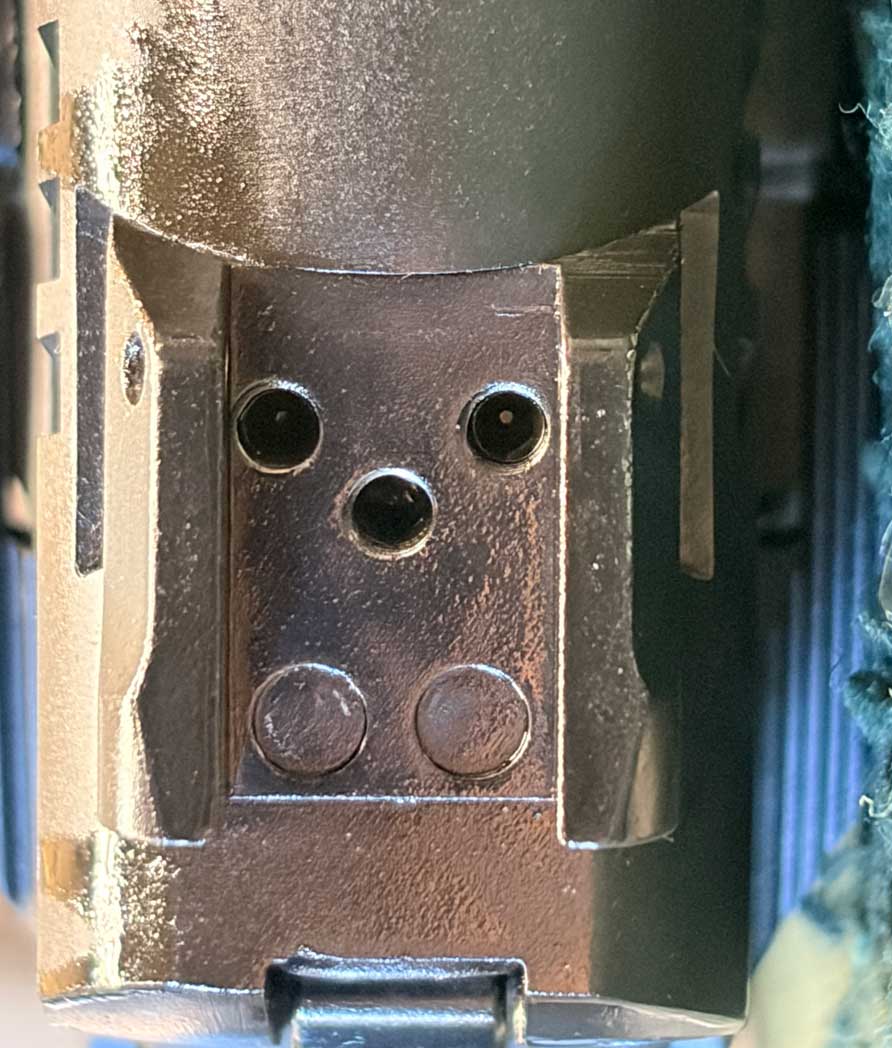

Back Story. I AM NOT a gunsmith. I have however removed or installed over 100 sights. Front and Rear. HK, FN, S&W, SIG, 1911, 2011, GLOCK ETC.
Tools I have or have used: MGW Armory SIGHT PRO, brass, aluminum, steel punches etc
Enter: Rock Island Armory Match Pro Ultra FS. Cheap 1911 I purchased on a whim. Actually shoots quite nice. Changed the grips, safety and moved to GI guide rod and plug. Hate the factory rear with its rounded corners and catty wampus tilting rear blade. Ordered a Kensight LPA TRT rear to replace.
The factory rear must come off.
Soaked in reds for a day, used sight pusher. NO JOY.
Soaked in reds for a day again. Used and bent or broke about a dozen brass and aluminum punches. WTF.
Soaked in Reds half a day. Busted out the REAL STEEL punches and 3lb mini sledge. SHEARED THE ENTIRE TOP half of the sight clean off. DOVETAIL DOESNT BUDGE a 🌮 HAIR
Tried Heat, started left to right from rear. Tried right to left. Tried center to right center to left.
Spent the rest of the day attempting to get said dovetail off in various ways. Even cut right down the middle with a mini saw. nothing moves.
WTF do they put on these things????
Currently defeated. Assessing the Situation. I'm thinking only a mill can save me at this point or I just send her off for an optic cut, though it was never meant to be that.
Photo up for your viewing pleasure and amusement.
No Damage but lots of aluminum and brass transfer that I have not removed.
