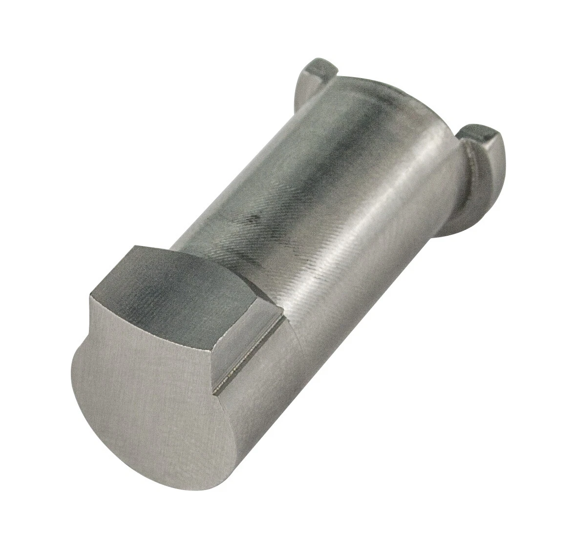

With the bull barrel did you have to modify the slide for the reverse plug? Also, tinkering with the idea of getting a Jarvis barrel in black. But that will be after I get everything else put together to see how it looks. My gunsmith friend said they called what I am doing a Palomino style. This all may take a while.

Only needed slight modification, I forget which brand the reverse plug was since it's been years, but it was nearly a direct fit

Unless you have a dedicated bull barrel slide (no bushing cut) that's normally cut for a reverse plug (typical bushing slides are not), then the slide does need to be cut to accept a reverse plug.
I use the EGW piloted carbide reamer for this job when I do them.
It's relatively simple job in a milling machine.
Let me see if I can find the reverse plug I used, it did not need a reamer and was nearly a direct fit, like this one, pretty sure it was EGW as they were the go to at the time for 1911 parts
If yours is like that and it dropped right into your slide, then your slide was already cut for it.
Standard slides that originally took barrel bushings usually are not cut for that.
It was a completely unmodified DGFM for $350, the plug I used looked like this one, but may have been different. It was a near direct fit. Only had to lightly sand the plug to get it to fit into the slide 🤷‍♂️
Are you sure it was not a hat style?
It very well could have been, we're talking 15 years ago, so it's not fresh in my brain how it was setup. It simply slid into the front end of the slide from the spring side and allowed the use of an FLGR. I remember it having a "foot" on the inside that followed the barrel, which helped make lockup tighter. That old DGFM had very loose tolerances, but shot like a dream once I put in the bull barrel and this plug.
Then you should NOT be saying it was a collar one like you said above because a collar one absolutely won't fit a slide that has not been opened up.
